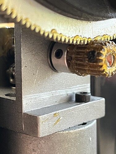

Hi, I’ve noticed recently that my Celestron NextStar 8SE alt-azth mount has some slack (or slop) in the gears only in the vertical direction. Wonder how I can remedy that situation? Do I need to bring it to Astronomics for a work-over or is there something else I can do? Any advice appreciable - thanks.

So my continuing saga on my altitude movement in my mount; I seem to have the clutch adjustment okay according to the videos
I watched, however, now when in aligning the slew in fast speed appears fine but when centering in the eyepiece and changing direction again in altitude the scope doesn’t move but i hear the motor going. Not sure what would cause this or how to fix it. Any suggestions welcome.
