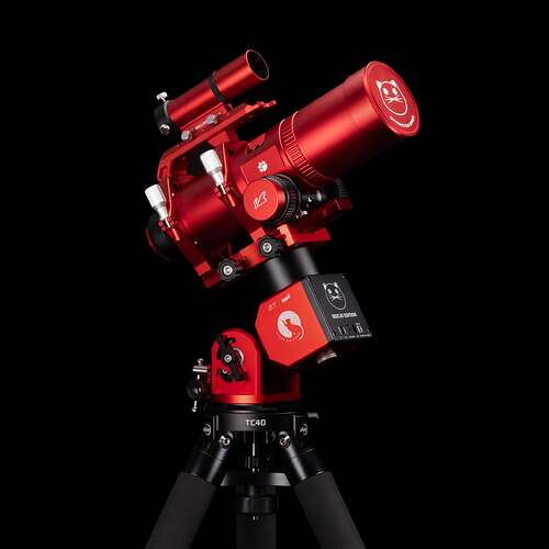

Thanks Andy. If you were building a rig around the AM5 for a beginner which scope and camera would you choose?
Sorry for the delay. Honestly, and unfortunately… it’s all about your budget.
Not wasting money on “beginner level” and “junk” will help you in the long run. I have lots and lots of older “beginner level” stuff, you end up stuck with it after you outgrow it.
For a small, portable setup: ZWO 65APO+AM3 bundle – Mile High Astronomy
Then just add the camera of your choice.
Also William Optics has some great bundles too: [Bundle] RedCat 51 WIFD & ZWO AM3 Full Package | WILLIAM OPTICS
