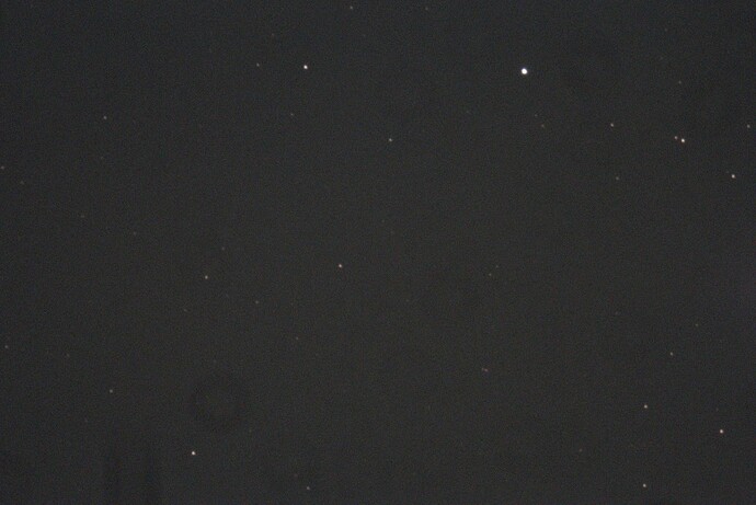

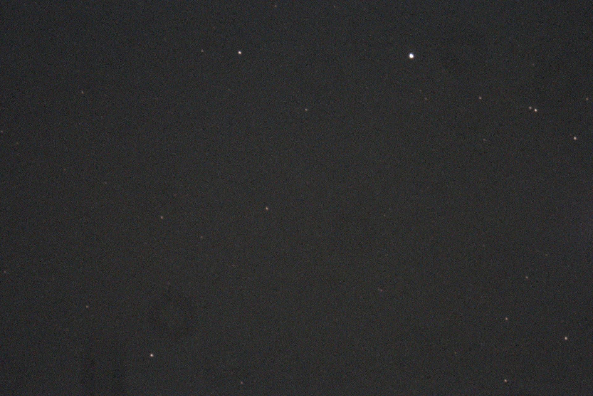

Star Field Near Polaris:
The Star Field shot is from a ZWO-183 color camera. The raw image, near Polaris, was taken on a “parked” mount. It is a 30 second exposure using a gain of 270.

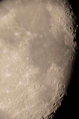

Moon:
The Moon image is of the Apollo 11 Landing Site (center of frame). It is also a raw image and was taken using the TeleVue 2.5x extender with a Nikon D5600 camera at 400 ISO with an exposure of 1/100 of a second.

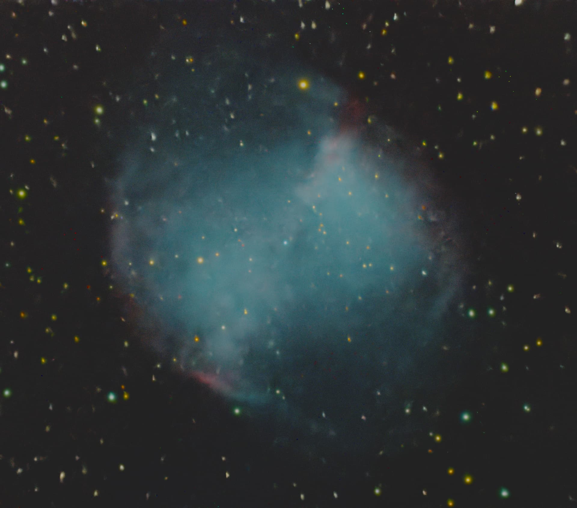

Dumbbell Nebula - Messier 27:
The Dumbbell Image is from an unguided stack of subs taken with the TeleVue Extender by a ZWO-183 color cooled astro-camera. The stack is a 22 minute integration using 22 subs with a 60s exposure and 0 gain. It was processed in PixInsight with appropriate darks and flats.

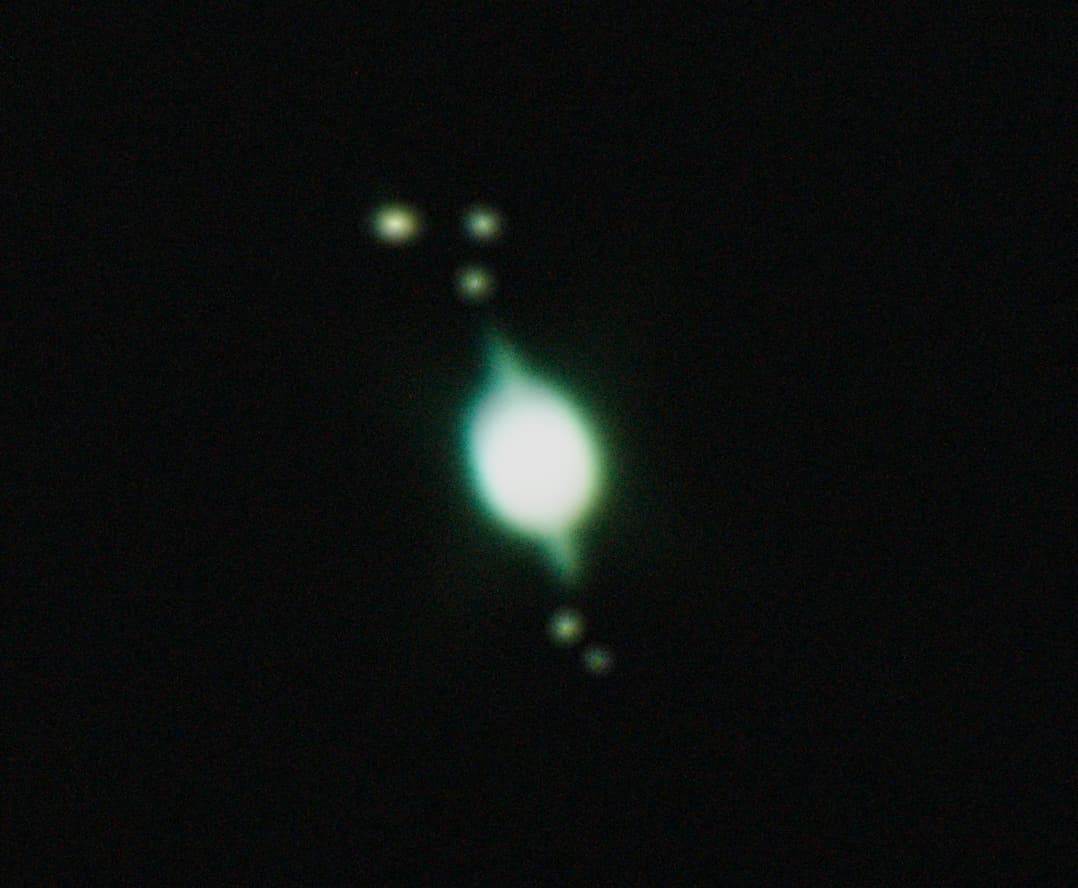

Saturn:
Saturn is an HDR Image from two image stacks using the TeleVue and taken by a Nikon d5600
- Body and Rings from 13 subs at 800 ISO and 0.005s exposure, and
- Moons from 11 subs at 26500 ISO and 0.1s exposure
It was processed mostly in PixInsight using PixelMath. The poor quality does not represent the telescope’s potential.
