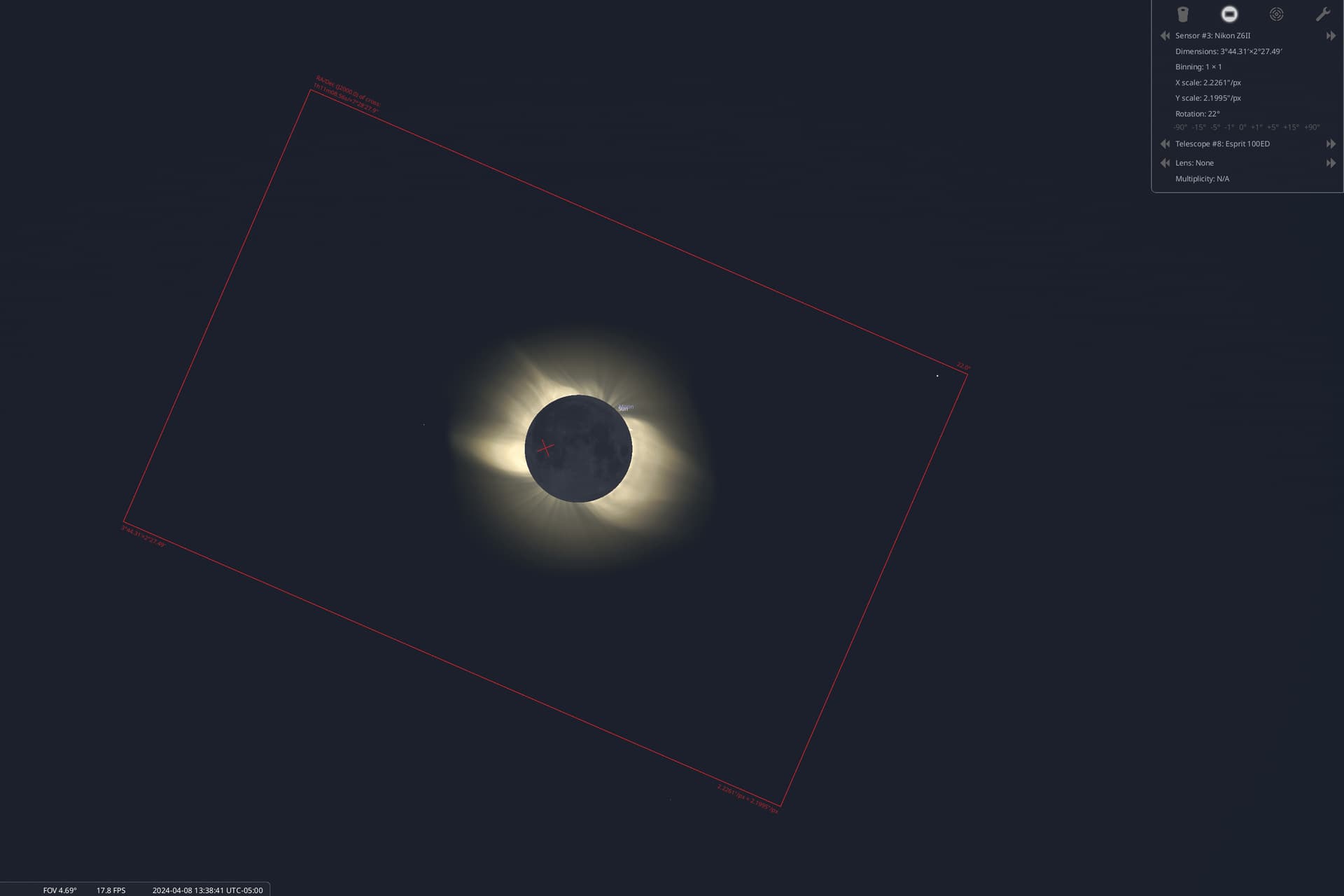

Thanks for posting the screenshot. Eclipse Orchestrator looks very impressive. Too bad it won’t work with my equipment. I should be able to automate the partial phases with SharpCap and only intervene manually just before and just after totality.
Also, thanks for the meridian flip reminder. I’d forgotten about that. I will be using an equatorial mount so that will be necessary. Looking at the Sun’s transit time for Cumby, Texas, I should be able to do it comfortably during the partial phase before totality.
Dang, now I’m thinking about running a 4k video with one camera, and then doing photos with the other two. That way, I can always pull out a 4k still frame from the video and edit it like a photo.

Also, 22 degrees camera rotation should be perfect for framing.
