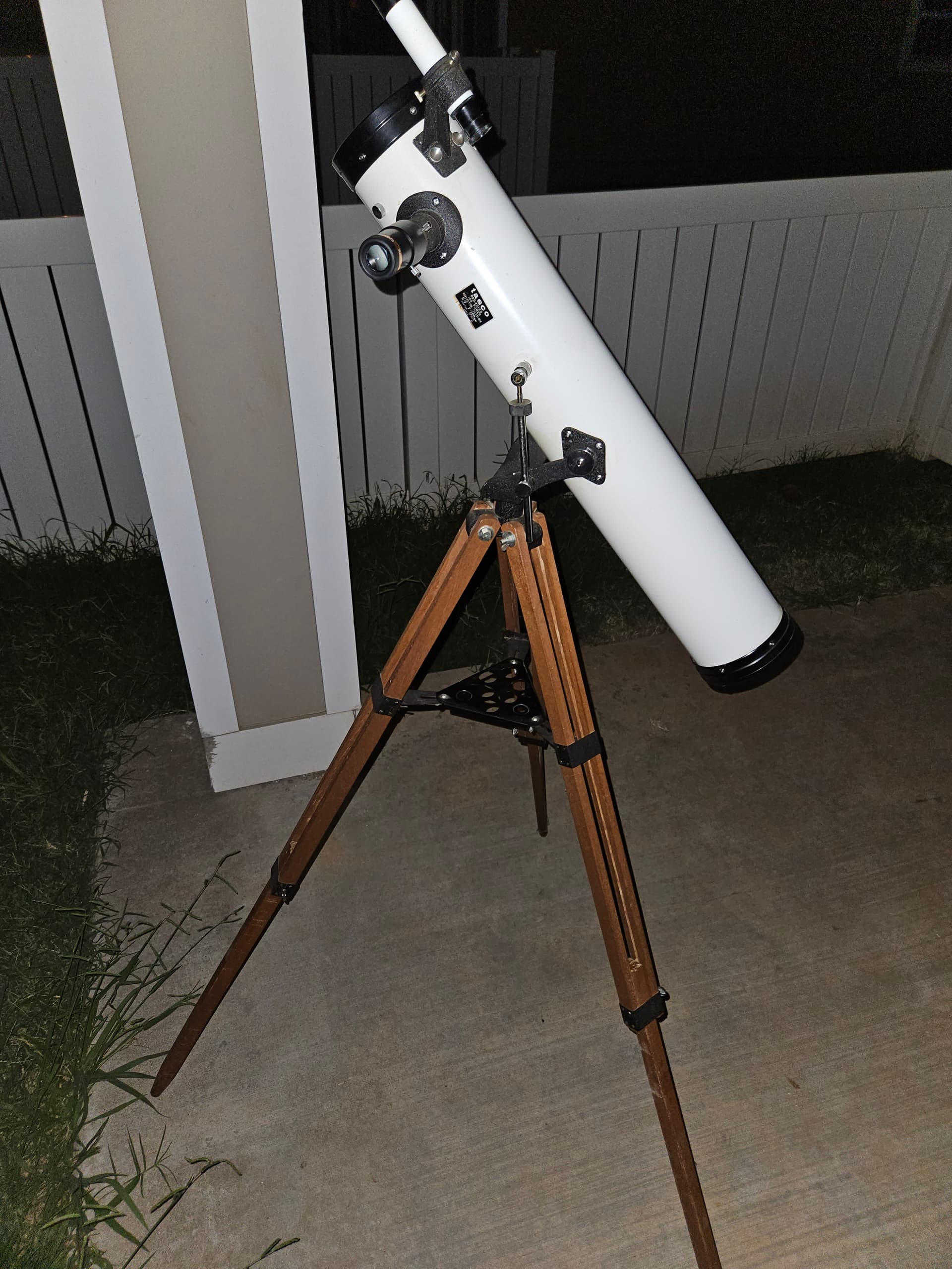

Back in late spring I got my first telescope, for free! Its a tasco 3" dob. However, it’s quite old. From what I can gather, it was made in the mid 60s.
I have been lightly working on it over the summer, getting the tripod in better shape, cleaning it, etc…
When I got it, I purchased a .95" → 1.25" adapter and got two eye pieces for it, 6mm plossl and a 23mm svbony.
My issue is whenever I use it all I can see is the arms attached to the secondary mirror as well as the secondary mirror. As I focus in to get the image clearer, it starts to get better. However, the focuser stops before it goes away. I know I need to collimate the mirrors, I am just tryibg to figure out how.
If the mirrors are collimated will this help with the issue or does the telescope need to “focus” more but can’t?
I have added pictures for reference.

The image seems to get better as I move the focus towards the secondary mirror. I am wondering if perhaps the issue is the adapter I have on it. I will need to bring it with me to the next viewing night.
I haven’t adjusted either of the mirrors, and as far as i know this was sitting for a long time. From what I can tell the prinary mirror is as far back as it will go.

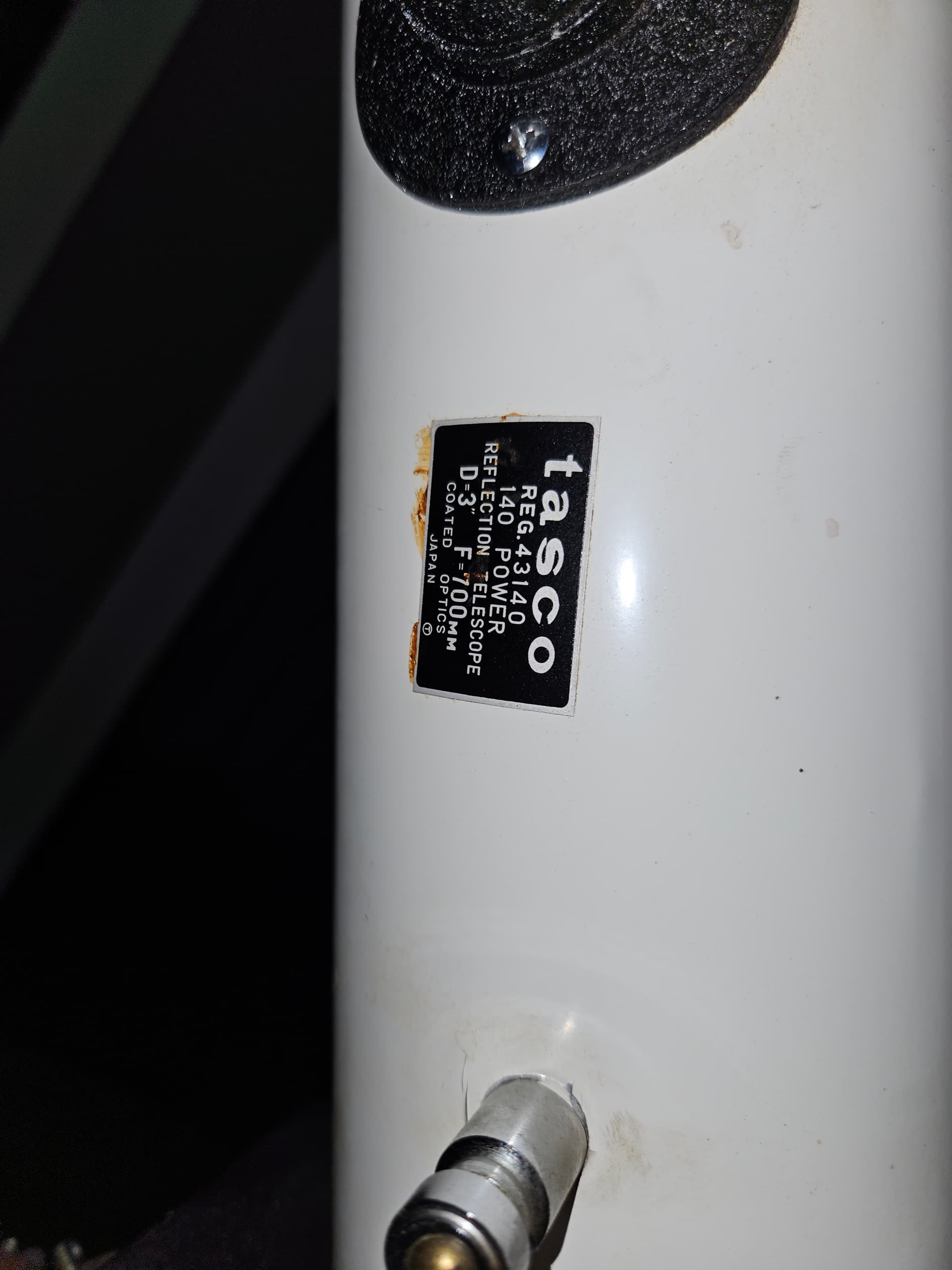

By the way, from the plate on your telescope, we see that the Focal Length is 700mm.
Using these eyepieces (6mm, 12.5mm, and 20mm), you’ll have magnification ranging from 35x to >100x:
700mm /20mm = 35x
700mm /12.5mm = 56x
700mm/ 6mm = 116x
